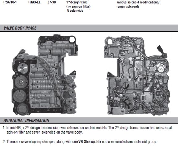

Post ALCYONE XT 1991 VERS ALCYONE SVX 1992
Hello
Viens de trouvez un lien
Pour boite auto alcyone svx 1 génération
http://www.makcotransmissionparts.com/storefront.html
SUBARU P23740-1 Valve body R4AX-EL , 87-98 , 1st design
Remanufactured valve body: various modifications, reman solenoids
Reference # P77990A
A $354.03
P23740-5 Valve body 4EAT , 98-00 , 2nd design (Spin-on filter)
Remanufactured valve body: w/tested solenoids
Reference # P77990C
Please note that core deposit maybe required before shipping.
$364.15
wub wub wub wub wub wub
